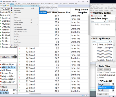

For example if I use the Tablet Production sample data set and want to filter (and exclude) by API Particle size, I can get the data filter ready with 'Select' ticked:

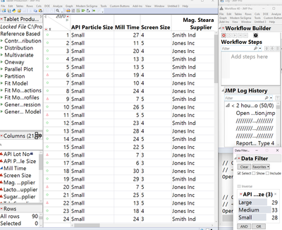

Then I can choose my selection (at this point the WB does not record any actions):

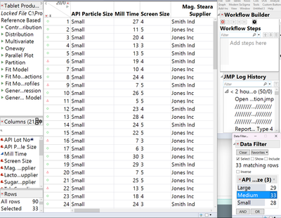

I can then apply a change to the row states manually (in this case hide and exclude):

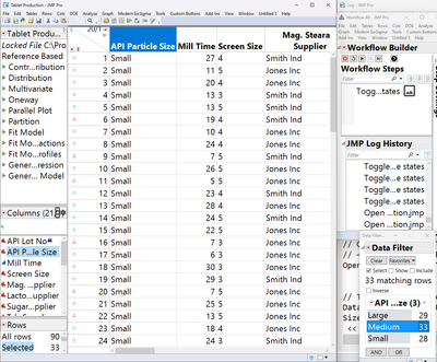

And then it appears as a step in the WB:
