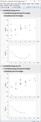

jthi
Re: Variability Chart Options script no longer working in JMP17
This seems to work fine for me (using JMP17.2)
Names Default To Here(1);
obj = dt << Variability Chart(
	Y(:height),
	Model("Main effect"),
	X(:age),
	Variability Analysis(
		:height,
		Show Range Bars(0),
		Show Cell Means(0),
		Std Dev Char(0),
		Points Jittered(1),
		Show Box Plots(0)
	by(:sex)
-Jarmo
ylee
Level III
Hi Jarmo,
Thanks for sharing.  I am on JMP17.0.0
I just tried pasting your script and running it, I could still see the Box Plots.
What I further discovered was that if the JMP Preference - Platform - Variability Charts options were selected/ticked to enable the said option, then JSL couldn't toggle it.  But if the option were not selected/ticked to begin with, JSL could toggle it -- this is referring to JMP17.
