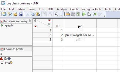

Using get picture seems to act differently with Graph Builder than with a Dashboard
big class summary.jpgI am creating images from Graph Builder and a Dashboard using the "get picture" function in JSL and inserting the images into an expression column in a table.  Everything works as expected when doing this from Graph Builder.  But when I use the "get picture" function from a Dashboard, my expression column doesn't include an image but instead a script that looks like: "{New Image(Char to Blob(....)}".
If I use JSL to strip off the opening bracket (i.e. "{" ) and the closing bracket (i.e., "}" ), then use JSL that looks like: eval(parse( "New Image..." )), then everything works and I get my dashboard as an image in the expression column.  Any ideas what is happening or what I should do differently?  BTW, I am using JMP 17.1.
I generated an example using the Big Class sample dataset.  The summary table with the expression column has a graphing script that allows you to hover over the points to see the graphs.

Re: Using get picture seems to act differently with Graph Builder than with a Dashboard
When you run this JSL on the dashboard:
rdash = dash << get windows;
The return value is always a list of windows, even if there is only one (which there usually is for the Dashboard case, but JMP Applications can have more).  When you send the <<GetPicture message to a list, you will get back a list of responses, but if you send it only to the first item in the list, you will get back a picture:
dashpic = rdash[1] << get picture;
2 REPLIES 2
Thank you @danschikore.
That makes perfect sense.
