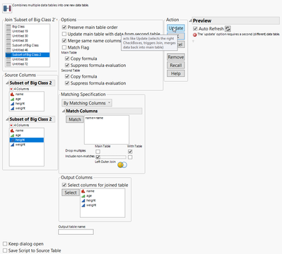

hogi
Level XIII
Re: Using Update() to add new rows into main table
I wrote a wish to add an option to update the main table:
Tables join: option to update main table
feel free to support it :)
