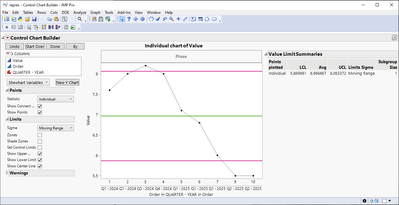

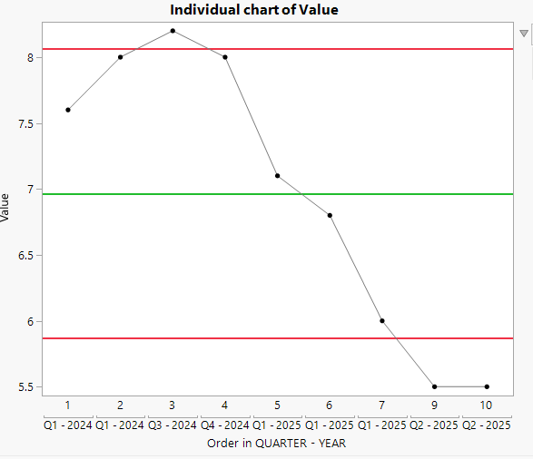

Expected (right order)

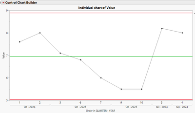

Obtained (wrong order)

Try adding Vale Order column property to your QUARTER-YEAR (Q3/Q4-2024 are in wrong location)

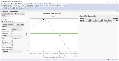

Which version of JMP are you using? JMP 19 made some changes to the default behavior, and the script on the data table supplied looks (I think?) how you want without any changes:

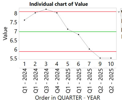

What version of JMP are you using? I just tried your script on v19.0.1. and it came out in the right order:
