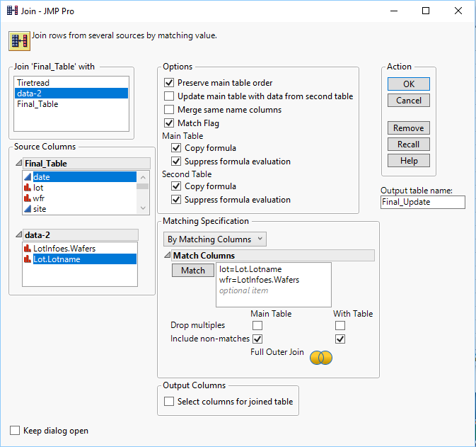

What I specified in my last response is exactly what you need to do to put the 2 data tables together, matching upon the 2 pairs of columns you indicated.  Below is the filled out dialog box from
     Tables==>Join
that when executed creates the output table you described.  Attached is the new table created.

txnelson
Re: Update or Match columns from 2 tables
Use the pull down menu item
     Tables==>Join
and you will be able to match the columns you need to match and it will generate a new data table
     Tables==>Join
