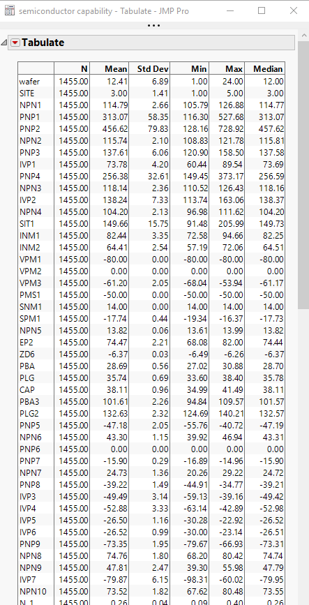

txnelson
Re: Tabulate all numeric columns in a table
Here is a rewrite of your code that uses a simpler way to get the numeric column names, and then adds the Eval() function around the list of numeric columns, to make it work
Names Default To Here( 1 );
dt = Open( "$SAMPLE_DATA/semiconductor capability.jmp" );
NumericCols = dt << get column names( numeric );
dt << Tabulate(
	Set Format( Uniform Format( 10, 2 ) ),
	Show Control Panel( 0 ),
	Add Table(
		Column Table( Statistics( N ) ),
		Column Table( Statistics( Mean, Std Dev ) ),
		Column Table( Statistics( Min, Max ) ),
		Column Table( Statistics( Median ) ),
		Row Table( Analysis Columns( Eval( Numericcols ) ) )
Jim

eliyahu100
Level III
PS.
I rewrote this code to work on continuous columns instead of numeric. This suits my needs better, since I have several columns which are in fact nominal but have numerical data and Value labels.
Here is the final code I used.
dt = currentdatatable();
continuousCols /*NumericCols */ = dt << get column names( continuous /*numeric*/  );
dt << Tabulate(
	Add Table(
		Row Table( Analysis Columns( Eval( continuousCols /*NumericCols */ ) ) )
Thanks a lot for your help!

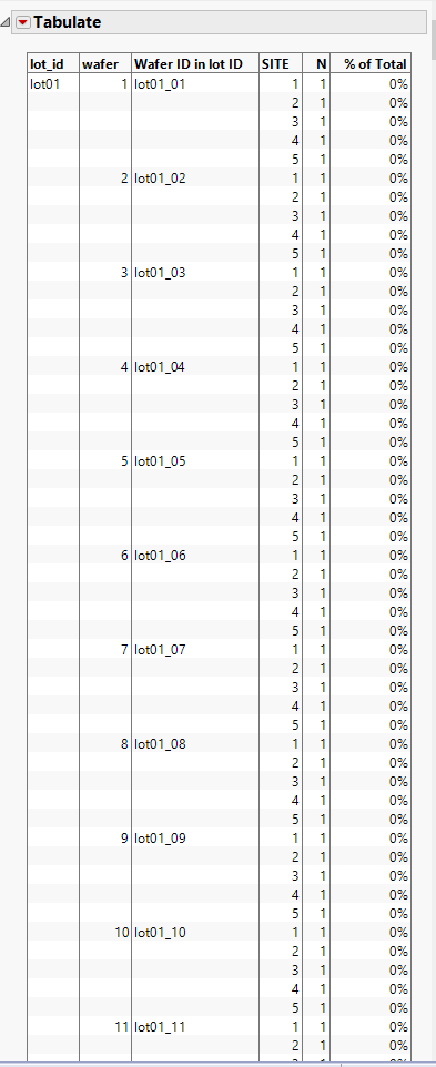

Thanks for the reply, but the code you posted does not provide me with the table i need.
here is the code, for the data file examole you used, which would give me the table i need.
You will note the output is different.
Tabulate(
	Add Table(
		Column Table( Statistics( N, Name( "% of Total" ) ) ),
		Row Table( Grouping Columns( :lot_id ) ),
		Row Table( Grouping Columns( :wafer ) ),
		Row Table( Grouping Columns( :Wafer ID in lot ID ) ),
		Row Table( Grouping Columns( :SITE ) )
The reason I assumed there is a difference is since here each row table is stated seperately, but for in the numerical data they were all under the same
"Row Table(Analysis Columns("
and then a list of the column names seperated by a comma.
This led me to think that for the numbers I could use a simple list but not for the charecter.
Thanks for the reference to the Scripting Guide I defenetly should find the time to study it!

Thanks again for bearing in with me. The second code you sent still does not give the results I need.
Please see below the results I am trying to get which is the outcome of the code i posted in previous post, followed by the results I get from your code.
This is what I would like to get:
This is what I get using the code posted:
TIA
txnelson
Here is one method to do what you want
CharacterCols = dt << get column names( nominal );
// Build a string variable that contains the required JSL
theExpr =
"dt << Tabulate(
	Add Table(
		Column Table( Statistics( N, Name( \!"% of Total\!" ) ) ),";
		For( i = 1, i <= N Items( CharacterCols ), i++,
		theExpr = theExpr ||
			"Row Table( Grouping Columns( " || char(CharacterCols[i]) || ") ),";
	theExpr = theExpr || "));";
// Execute the JSL
eval(parse(theExpr));
Other Community members may have a better method
Jim
