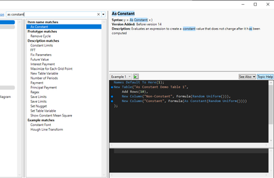

To get explanation about used functions I would suggest first using Scripting Index to search for the function and then clicking "Topic Help" to get to help page. For example search for "as constant"
and click topic help to open this page As Constant(expr)
