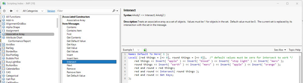

There are 2 ways to intersect (and other set operations like union, difference)
a) using associative arrays
aa1 = associative array (myRows1);
aa2 = associative array (myRows2);
aa1 << intersect(aa2);
// aa1 << remove(aa2); list of rows = aa1 << get keys; rows= matrix(list of rows);

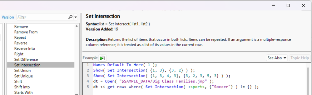

b) [new in JMP19]: using lists
list1 = as list (myRows1);
list2 = as list (myRows2);
list of rows = set intersect(list1, list2);
list of rows = set intersection(list1, list2);
//list of rows = set difference(list1, list2);

One clarification, I used your syntax
initially and it turned blue so I thought it was okay, but odd that it didn't capitalize.  Then I looked it up in scripting guide and realized it was "Set Intersection".   Now I'm good to go.  Cheers!
