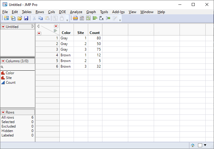

Here is the JMP data table that supports a contingency table analysis:

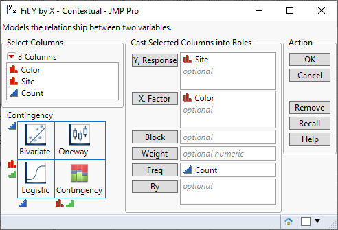

Select Analyze > Fit Y by X and assign the data columns to the specific analysis roles as shown here:
(I might have mistaken the analysis roles. Perhaps Color is the response and Site is the factor.)

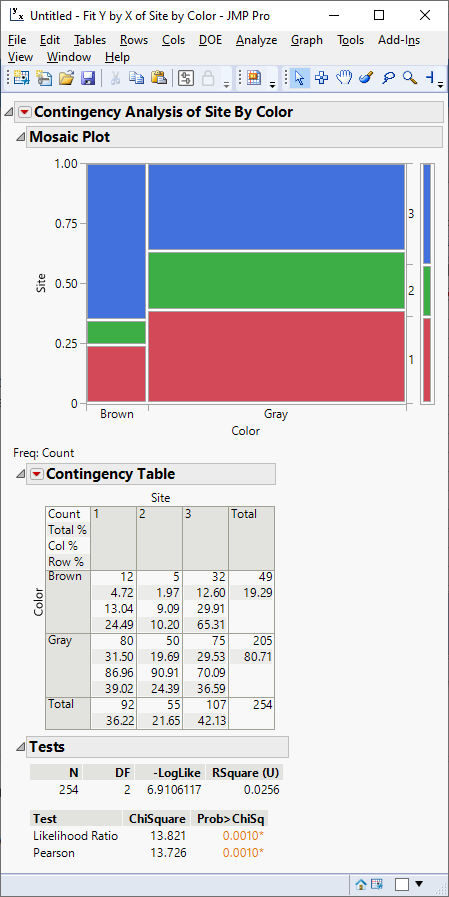

Click OK to launch the Contingency platform:
This analysis compares the counts of the colors at the sites to what would be expected if there were no association between Site and Color.. The whole model test is based on a chi-square distribution of the test statistic. The test statistic is obtained using two different methods: Likelihood Ratio Test (LRT) and Pearson chi-square.

Thank you very much for your answer. I did the same test but I choose site and color both as a x factor and I put count as a response which I thought doesn't make sound.

OK, then Color is in the Y role and Site is in the X role. Use Count in the Freq role.
