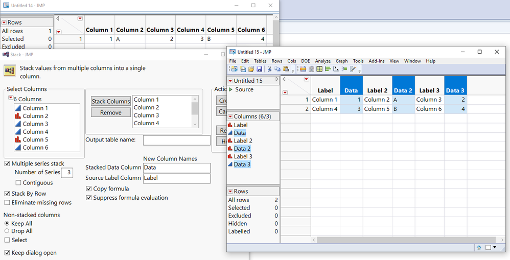

You should be able to do that by just checking Multiple Series Stack, and Number of Series = 3. You'll just have to delete the resulting labels columns afterwards. I tested it with 6 columns where the 2nd and 4th were both nominal and the resulting table had 3 label and 3 data columns. The second data column had a nominal data type as would be expected.
-- Cameron Willden
