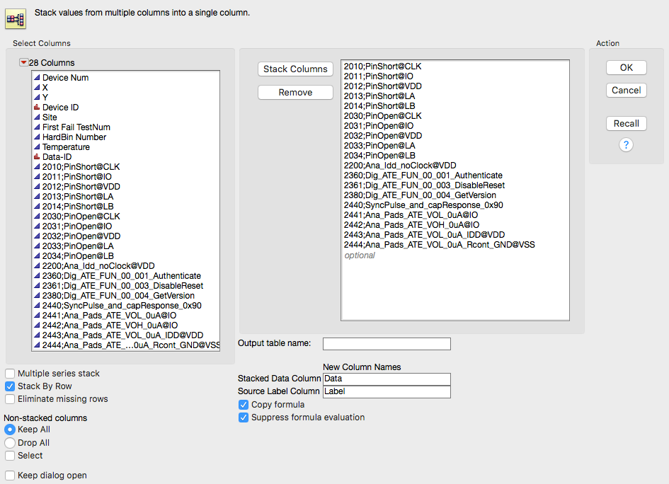

If you can, it's a good idea to let JMP do the work for you - Generally you only need to do things 'by hand' once, then use the code that JMP generates automatically.
In you case, if you do 'Tables > Stack':
Screen Shot 2019-08-29 at 10.02.00.pngScreen Shot 2019-08-29 at 10.02.00.png
hitting 'OK' gives a new table that has a saved script called 'Source'. If you right-click on the associated green 'run' icon, you can select 'Edit', which will give you this script:

You can make this script smarter, but if you are just adding new rows it will work fine (so long as the columns it needs are still in the source table).
