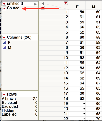

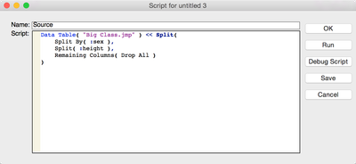

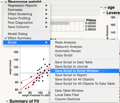

The best way to learn, and, frankly, to write, JSL is to let JMP do it for you. That is, you do what you want to do interactively, using the menus and then ask JMP to give you the script.
For analysis platforms, you get the script from the hotspot at the top of the report.
For the Tables menu operations, the resulting table will have a Source script that will reproduce the data table.
