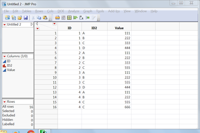

I'm having an issue with the splitting of a data table and was wondering if someone knows how to it. My data looks like this:

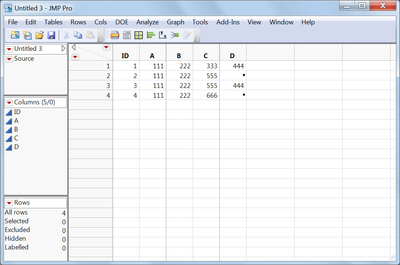

The data should be Split by ID2 ​with ID being  the group variable. When I am doing it that way I end up with this result:

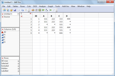

The Problem is that for IDs 2 and 4 there are multiple values of C in column ID2. As it seems JMP is always using the last value in the splitted data table.
Is there any automatic way to do it so that I end up with a table like the following?
Here there are two rows for IDs 2 and 4 representing the different values of C in the original data.
