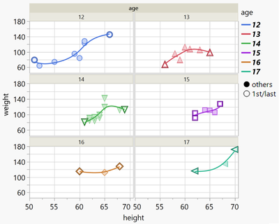

hogi
Level XIII
Re: Some Questions about "Style" in Graph Builder
2)
I use markers very often to distinguish different variants.
Sometimes, I  have a second yes/no information and I and want to use hollow: yes/no to show this info in the plot.
here: the first/last data point per group.
In Graph builder, is it possible to use one column (age) for MARKER - and another column (first or last) for HOLLOW: yes/no?
Names Default to Here(1);
New Column( "first or last",
	"Nominal",
	Formula(
		:height == Col Min( :height, :age ) | :height == Col Max( :height, :age )
