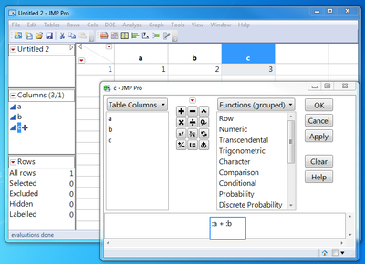

Copy and paste works in the formula editor (right-click at the top of the column, pick Formula Editor):
