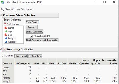

or use Column Viewer as it gives additional information in easy to see format and allows quick creation of distributions.

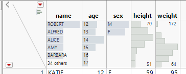

I'm sure someone will give you such a script - but why isn't the display that appears just below the variable name sufficient?  And, if you want the statistics (e.g., means, standard deviations, etc.) you can use either the Column Viewer - summary or select all distributions and then make a combined data table.  Of course, those scripts can be saved to the data table, so JMP will write the scripts (sorry, but I'm allergic to writing scripts if I can avoid them).

But I would think @dale_lehman suggestion would be better in most cases. At least JMP15 provides distributions below column names
