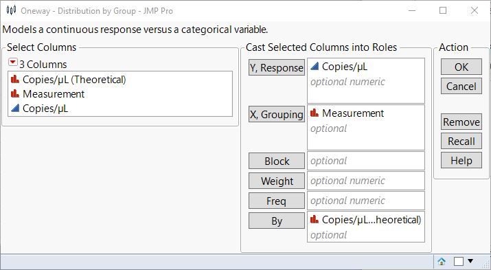

2. Select Analyze > Fit Y by X. Assign Copies to the Y role. Assign Measurement to the X role. Assign Copies Theoretical to the By role. Click OK.

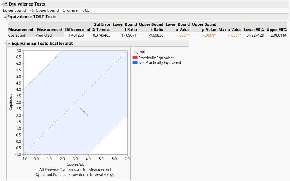

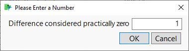

3. Now you have a separate Copies versus Measure for each Theoretical level. Press and hold the Control key on Windows or the Command key on Macintosh, click the red triangle next to the top outline, and select Equivalence Test. You must enter the difference that is considered to be the largest but still practically the same. For example, let's say that if the measured copies for the theoretical sample = 0.3 is within 1, enter 1, and click OK:
JMP updates the first analysis:
In this demonstration, the observed difference is statistically not equivalent.

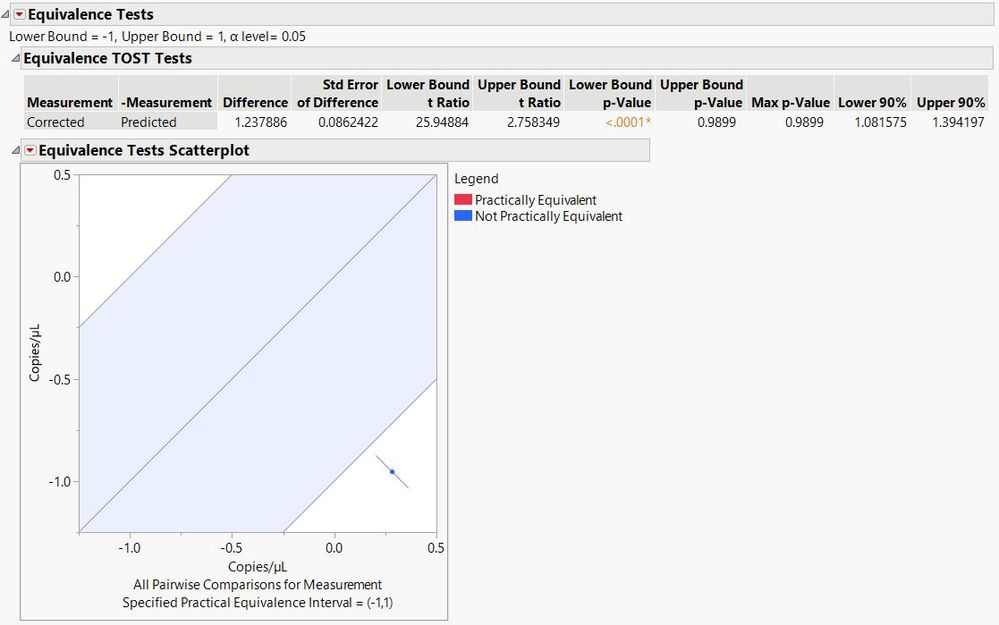

Here is the next sample:
This sample is statistically equivalent.

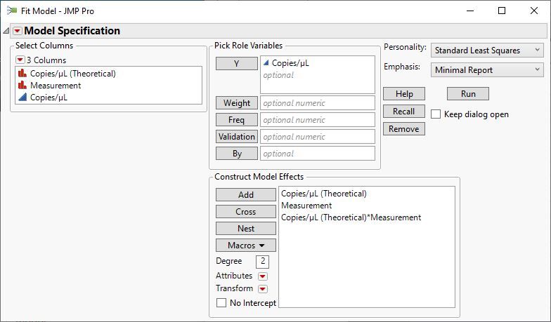

The analysis with Measurement in the By role produces two independent analyses. Instead, you should analyze the data together using an 'analysis of covariance' model. Select Analyze > Fit Model and assign the columns to the analysis roles like this:

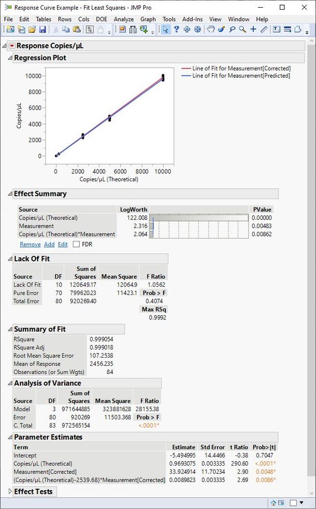

Click Run and the results are as follows:
The intercept is not significantly different from 0. The slope is significant as expected. The Measurement is also significant, indicating that the intercept is different between the two measurements. Finally, the crossed term for the interaction is significant, indicating the that slope is different between the two measurements as well.
