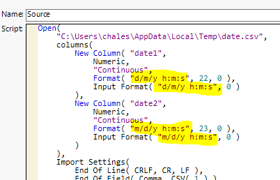

date1 is d/m/y, date2 is m/d/y, source script high lighteddate1 is d/m/y, date2 is m/d/y, source script high lighted
The Source script looks like this
High lighting the two date formatsHigh lighting the two date formats
JSL can edit the source script, substituting the desired format. Then run the modified script and add some columns to show off the month:

date2 is now d/m/ydate2 is now d/m/y
