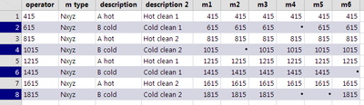

I have a table that looks like the table below:
operator M type description description 2 M1 M2 M3 M4 M5 M6
415 Nxyz A hot Hot clean 1 415 415 415 415 415 415
615 Nxyz B cold Cold clean 1 615 615 615   615 615
815 Nxyz A hot Hot clean 2 815 815 815 815 815 815
1015 Nxyz B cold Cold clean 2 1015   1015 1015 1015 1015
1215 Nxyz A hot Hot clean 1 1215 1215 1215 1215 1215 1215
1415 Nxyz B cold Cold clean 1 1415 1415 1415 1415 1415
1615 Nxyz A hot Hot clean 2 1615 1615 1615 1615 1615 1615
1815 Nxyz B cold Cold clean 2 1815 1815 1815     1815
I want to select only the rows that is empty. Since the columns M1-M6 can vary each time I pull the data I can't use the column names in the JSL script. I'm trying to use a FOR loop below to select the rows of empty data, but this only selects the rows where the last cell is empty.

Eventually I want to get the output table to look like the following
operator M type description description 2 Machine
615 Nxyz B cold Cold clean 1 M4
1015 Nxyz B cold Cold clean 2 M2
1415 Nxyz B cold Cold clean 1 M6
1815 Nxyz B cold Cold clean 2 M4
1815 Nxyz B cold Cold clean 2 M5
The big trick to this is to do this without coding in the column names for (M1,M2 etc...) as they are going to change.
Any Ideas
