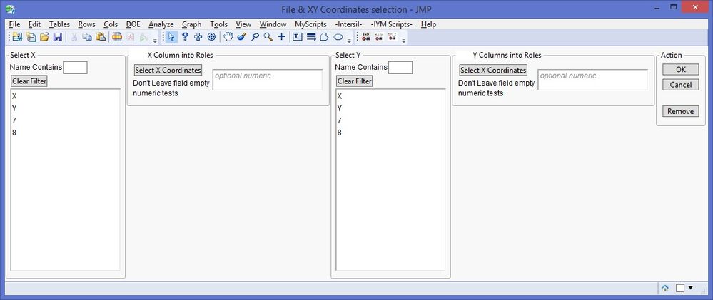

Prompt User to Select a Column(s) by popup window
Hi Guys, I am trying to have script prompt the user to select 2 columns x-coordinate and another y-coordinate from a table.
Graph below is what I like the script to do. User picks the x,y coordinate then I use it to pass it on as a variable. I need it in the script later to do die mapping. any ideas? thanks graph below is photo shop to show end result.
thanks.
txnelson
Re: Prompt User to Select a Column(s) by popup window
I suggest that you look into the JMP Addin on "Runs Test" which contains an example of doing what you are asking to do with your example.  It provides a dialog box that allows for the selection of column and placing them into selection boxes.  It also has filtering capability and Recall capability in it.
Runs Test (Wald-Wolfowitz Test) and JSL Implementation of JMP Platform Dialog Box
Jim

txnelson
Download the Addin to your downloads folder
Then go to JMP and
     File==>Open
Go to the download folder
Single click on the Runs Test.jmpaddin file
Then go to the down arrow for the Open button, and select
     Open using the Addin Builder
In the Addin Builder, select the Menu Items tab
Then click on the Runs Test entry
In the "Run this JSL" area, you will see the embedded script
Cut and paste it to a Script Window
Jim
