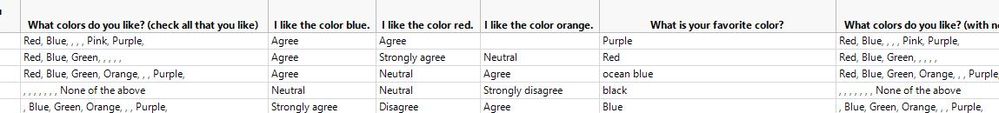

I have an analysis I'd like to perform but I need to select several columns based on the words contained in the header befre I can do this, currently I do this manually but this is painfully slow and I can miss some columns if I'm not careful.
in the image example I would like to select the 2 columns starting 'What colors' but none of the other 4. They can be spread amongst other columns and the number of them will be different per experiment. Once selected I can then extract them and perform the analysis.
This needs to be done automatically without any user input involved and I can't find any jsl that does this but I'm sure it must exist, it's just that I haven't been able to find it or don't know the correct scripting term.
