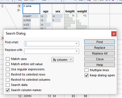

Hi,
Objective: I would like to cleanup Column names before export into graph database.  The import prices into the graph database would be much easier if I remove the spaces in the column names.  If I go to edit>Search>Find.  In the dialog box I enter a single space character into "Find What:" and clear the text in the "Replace With:" restrict to column names.  It finds nothing and replaces nothing.  Shouldn't this work?

Re: Search and Replace on " " (Space) does not work
I think I figured out what was going on.
Previously I must have done a search with multiple spaces and when I entered a single space it pulled that previous search term. Notice the extra highlight on those spaces.  When I deleted them out it worked as expected.
