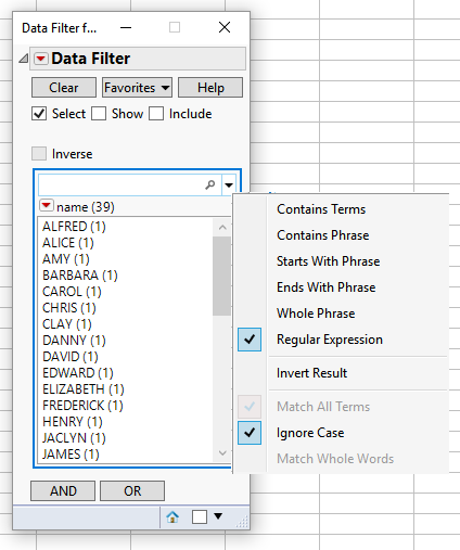

Full disclosure: I'm not a coder and JSL gives me a particularly difficult time, however I feel that this portion of the script I am writing should be far easier than it has been. I use the Data Filter frequently, with "Find" and "Regular Expressions" enabled (see image), however there is no option to save these settings so they must be cumbersomely re-enabled every time I open the filter. What I would like is an embedded table script that:

Find and Regex are not saved with the script . . .

For the Find and Regex options... I doubt that is even possible.  If you look at the Data Filter() documentation in the scripting guide there is no mention of those options.  I doubt the scripting interface has that level of granularity and those tickboxes can only be brought up interactively.  I may be wrong, though.  Someone else might chime in with a solution for that.

@Chris_Rodrigues has a handle on how to get the variable to evaluate inside the Data Filter() message, and I can confirm that there is no JSL support for turning on the Find and Regex options.
If you feel that would be valuable, be sure to enter it in the JMP Wish List.
