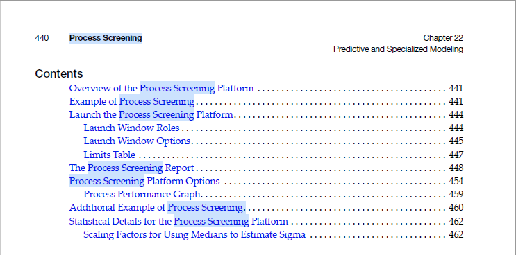

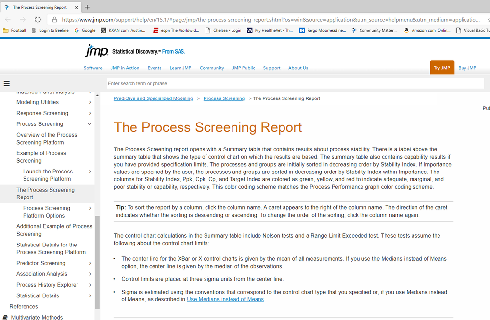

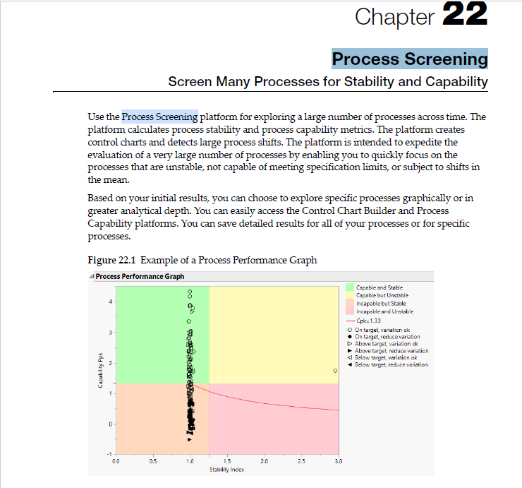

Details on this report, and on all reports can be found in the JMP Help system.
To go directly to the help you want, just go to the Tool Bar, and select the Help Tool.."?".  Then move the cursor to what you want help on, and Click on it.  If you click on the Process Screening report, you will get the above help screen.
Documentation on Process Screening including the Statistical Details is easily accessed under the Help pull down menu.  Just go to
     Help==>JMP Documentation Library
If you search on "Process Screening" it will go to
And the Table of Contents for Section 22 contains the following
