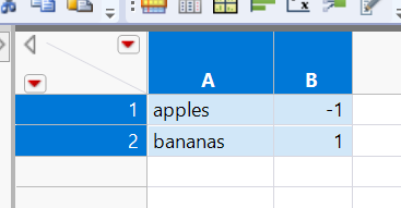

Good Afternoon,
Is there a way with either GUI or jsl to save an ordinary data table as a factors table?
For example: SaveAsFactorsExample.PNG
Kind Regards,
Ben
brfrancis
Level II
Re: Saving a data table as a factors table
Thanks for your answers Jim and Ian, I don't think I added enough detail to my question. I basically have a data table of a lot of factors (and their low/high, categorical values) that I want to get into a DOE dialog and don't wish to go through one by one and put them in the DOE.
The code below worked (Jim you'll notice a code snippet from another question you answered). After doing this script, going into the DOE and using "Load Factors" populates with the required information.

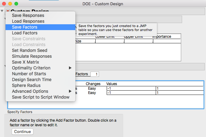

Probably you know this already, but if you use the GUI to get things the way you want, you can then 'Save Factors' to make the table you are after:
If you then want to use JSL, you can always get the script to regenerate the resulting table from 'Copy Table Script' from the red triangle. You then paste the clipboard into a new script window, and proceed from there . . .
