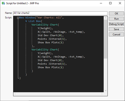

You need to use Parse() to remove the quotes (no need for Eval() as you want the expression). Below are few options
Names Default To Here(1);
dt = New Table("");
plotcolsString = {"height", "weight"};
plotAllStandardExpr = "New Window(\!"Var Charts: All\!", V List Box(";
For(i = 1, i <= N Items(plotcolsString), i++,
	plotAllStandardExpr = plotAllStandardExpr || "Variability Chart(
				Y(" || plotcolsString[i]
				X( :Split, :Voltage, :tst_temp ),
				Std Dev Chart( 0 ),
				Points Jittered( 1 ),
				Show Box Plots( 1 ))
plotAllStandardExpr = plotAllStandardExpr || "))";
Parse(plotAllStandardExpr);
Eval(EvalExpr(dt << New Script("all var charts", Expr(Parse(plotAllStandardExpr)))));
Eval(Substitute(
	Expr(dt << New Script("All Var charts2", _script_)),
	Expr(_script_), Parse(plotAllStandardExpr))
-Jarmo
dt = New Table("");
				Std Dev Chart( 0 ),
Eval(Substitute(
-Jarmo

Re: Saving New Script to data table from expression
Thanks very much. Both options worked as advertised!
