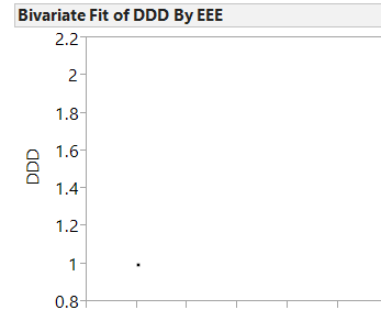

I am having a problem that looks like it is specific to my computer.  I am running jmp 11.2 on windows 8.1 (64 bit).
It doesn't happen on my colleagues' setup so I figure there is a setting somewhere I am missing.  Here it is how to reproduce it....
Use the following code to create a trivial table, plot and then save the plot to my pc....
ttt = New Table( "test", Add Rows( 2 ), New Column( "DDD", Set Values( [1, 2] )), New Column( "EEE", Set Values( [3, 4] )));
vvv = ttt << Bivariate( Y( :DDD ), X( :EEE ) );
ppp = vvv << Get Picture;
ppp << Save Picture("c:\Temp\test.png",PNG);
When I look at the saved picture, it is cut off....
I am finding that every time I save a picture it is always cut off when I save it.

I simply rebooted and the problem went away.  That said, I switch between my laptop's screen and my docking station screen pretty often and I had noticed that some features on my screen were enlarged.  So, perhaps screen scaling was the issue.

Have you set your screen scaling?  I think we had some measuring issues related to this at one time.  See if it works better at 100%.  Needs a reboot.
