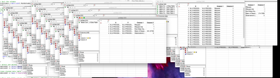

New JSL user here. I have a nested for loop where I am using a bivariate platform to extract Rsq for each pair and creating a concatenated data table which will eventually hold all Rsq values for all pairs. I am able to get the desired output in the end. However, while the script is running, I get temp tables to pop up and I cannot seem to make them invisible or close (post contenation to another table).
Is there a way to flip a switch and turn off any windows to pop up? If not, anyone have a suggestion how to not have the screen keep popping tables while running? Output of the script while running is in the attachment.
