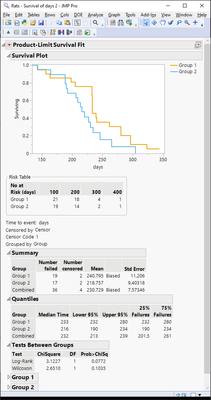

I attempted to parametrize the code a bit further, does this do what you are looking for if you change minT, maxT, stepT, ycol, grouping and use your table
Names Default To Here(1);
dt = Open("$SAMPLE_DATA/Rats.jmp");
minT = 100;
maxT = 350;
stepT = 50;
ycol = "days";
grouping = "Group";
Summarize(dt, groups = by(Eval(grouping)));
obj = dt << Survival(
	Y(Eval(ycol)),
	Censor(:Censor),
	Grouping(Eval(grouping)),
	Show Points(1),
	SendToReport(
		Dispatch({"Survival Plot"}, "1", ScaleBox,
			{Min(minT), Max(maxT), Inc(stepT), Minor Ticks(1)}
rep = Report(obj);
rep[List Box(2)] << append(tb = Table Box(String Col Box("No at Risk ("||ycol||")", groups)));
rep[List Box(2)] << Append(Spacer Box(Size(0,20)));
tabs = {};
For Each({group}, groups,
	Insert Into(tabs, Eval List({rep[OutlineBox(group), Table Box(1)] << get}));
For(T = minT, T <= maxT, T += stepT,
	ARs = {};
	For Each({tab}, tabs,
		lp = Max(Loc(Matrix(tab[ycol]) <= T));
		Insert Into(ARS, tab["At Risk"][lp])
	tb << append(Number Col Box(Char(T), ARs));
Edit: small fixes

jthi
Re: Risk Table of KM plot on JMP?
minT = 100;
maxT = 350;
stepT = 50;
ycol = "days";
grouping = "Group";
	Y(Eval(ycol)),
	Censor(:Censor),
	Show Points(1),
	SendToReport(
rep = Report(obj);
tabs = {};
	ARs = {};
Edit: small fixes
-Jarmo
doraemengs
Level III
Hi Jarmo, Thank you for your help. It worked!
Best, Theerachai

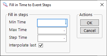

Here is also a script which can be used basically on Survivor report. It might work in most of the cases but  not sure if it will as I'm not that familiar with this JMP Platform or analysis. I also modified the calculations so they might not be exactly correct
First you have to have Survivor report open
then you can run the script and it will ask for few things
Fill in those and press OK
It will then add the table to your existing report
Script below (and also attached). Use at your own risk, the calculations have not been checked
View more...
ask_steps = function({}, {Default Local},
	nw = New Window("Fill in Time to Event Steps", << Type("Modal Dialog"), << Return Result,
		H List Box(
			Panel Box("Fill in steps",
				Lineup Box(N Col(2),
					Text Box("Min Time"),
					neb_min = Number Edit Box(.),
					Text Box("Max Time"),
					neb_max = Number Edit Box(.),
					Text Box("Step Time"),
					neb_step = Number Edit Box(.),
					Text Box("Interpolate last"),
					cb_interpolate = Check Box({""}, << Set All(1))
			Spacer Box(Size(20, 0)),
			Panel Box("Actions",
				Button Box("OK"),
				Button Box("Cancel")
		, << Set Window Icon("Survival")
	If(nw["Button"] != 1,
		Throw("Cancelled");
	min_t = nw["neb_min"];
	max_t = nw["neb_max"];
	step_t = nw["neb_step"];
	If(Any(Is Missing(min_t), Is Missing(max_t), Is Missing(step_t)),
		Throw("Steps not filled in");
	interpolate_last = N Items(nw["cb_interpolate"]);
	return(Eval List({min_t, max_t, step_t, interpolate_last}));

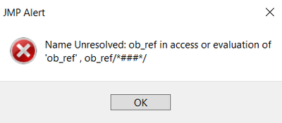

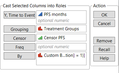

Thanks for this script! I really like it. When I generate multiple survival curves at once using the set up below ("Grouping" and "By" specified), the at risk table is only added to the first plot. Is there a way to have it added to all of them?
jthi
It should be possible but will require modifications to the script. You can try if this version works for you:
View more...

There are only few changes I did to the end of script, I basically just added one for each loop (and changed one variable name).
-Jarmo
Thanks for the quick reply! I am getting this message though?
jthi
One s is missing  from line 100
I edited my earlier post to fix the issue
-Jarmo
