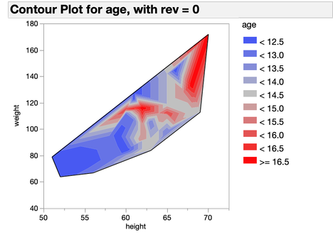

Thanks for your reply! I am using JMP 14.2.0 on MacOS 10.14.6.
I tried your script but I am still seeing the same problem. I added this to the script so I was sure I was getting the correct output:
SendToReport(
	Dispatch( {}, "Contour Plot for age", OutlineBox, {Set Title( "Contour Plot for age, with rev = " || Char( rev ) )} )
And the charts look like this (I also filled the contours to make it more obvious):

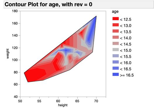

As before, if I hardcode in
Reverse Colors( 0 )
Then I get this (which is correct):
Hope this helps. Thanks!
