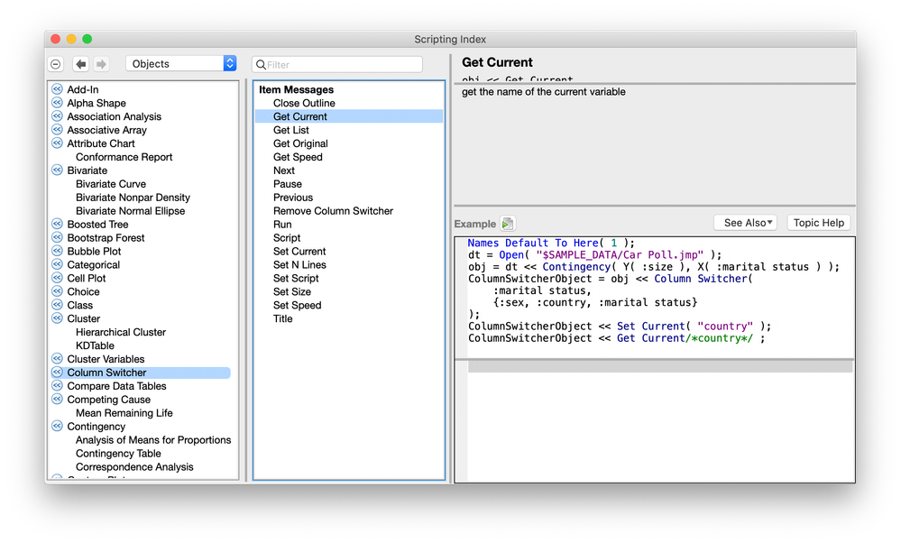

Re: Return a selected column name from graph builder
To @txnelson's point, the documentation and the Scripting Index will inform you that the Column Switcher is an object with its own protocol, including the message << Get Current specifically for your need.
