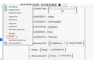

It may be helpful to know that you can covert the second expression to the first by saving the prediction formula to the table, opening it using the Formula editor and selecting "Simplify" from the red-triangle menu:

Thank you for showing me the means to a simplified version of the regression equation. I am still new to regression modelling. I also wanted to know why we do not use the parameter estimates as they are. What is usually the reason behind centering the predictor variables using the centre points in the prediction expression?
