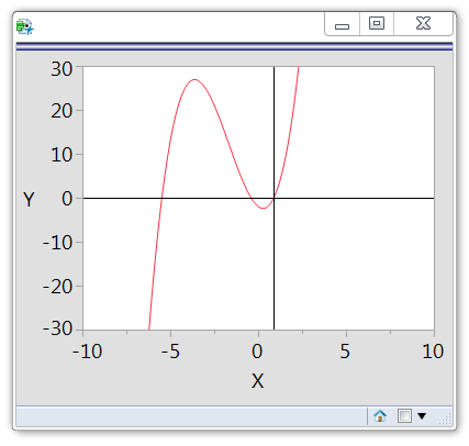

(Not a mathematician, I'm sure this has some flaws...) Similar to your original idea, but make JSL do the work. I'm pretty sure Minimize has seen some improvements since JMP 10. https://community.jmp.com/t5/JMPer-Cable/Minimize-and-Maximize-Functions-in-JSL/ba-p/36355/jump-to/f...
a = -2;
b = -3;
c = 5;
d = 1;
f = Function( {x},
    a + b * x + c * x * x + d * x * x * x
lo = -1e99;
hi = 1e99;
vlo = f( lo );
vhi = f( hi );
v = 1;
nn=0;
While( (abs(v)>1e-15)  ,
    test = (lo + hi) / 2;
    v = f( test );
    If( v > 0,
        If(
            vhi > 0, hi = test,
            vlo > 0, lo = test
        If(
            vhi < 0, hi = test,
            vlo < 0, lo = test
New Window( "Example",
    Graph Box(
        X Scale( -10, 10 ),
        Y Scale( -30, 30 ),
        Pen Color( "red" );
        Y Function( f(x), x );
        pencolor("black");
        V Line( test );
        hline(0);
Capture.PNGFound a zero
If the coefficients on the ^2 and ^3 terms are too big, you'll need to make the -1e99 to 1e99 interval smaller.
