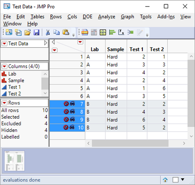

Hello,
I am kind of new in JMP scripting. So, I would really appreciate if anybody can help me in this basic scripting steps.
I would like to read above data as following:
Read Test 1 (or Test 2) data for Lab A (or Lab B) and put it in the following format as an example:
Data for Lab A Test 1 = [2, 3, 4, 2, 1]
Data for Lab A Test 2 = [1, 3, 2, 4, 6]
and so on.
Is it possible to show the above data in the scripting window itself so that I could write more scrips to analyze the data (like mean, standard deviation etc)?
Thank you so much in advance.

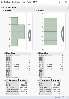

What I am curious about is your question about putting the above data into a script window.  I am not sure where you are going with that?  While you can certainly write scripts in JMP, much like you have to do in R or Python, doing most analyses in JMP are much simpler to just use the interactive items.  You mention that you want to put the data into a script so you can analyze the data, like mean, std dev, etc.    Getting such results using the Tabulate or Distribution platforms, where you just specify which columns to analyze seem to be what you should really be doing.

One more question, can I make a loop to calculate the results for both Lab A/Lab B and for both of test 1/test 2? It is easy to do it in Matlab but as I said I am still learning to write script in JMP. Also, if possible saving or exporting the final result in excel would be nice.
Thanks again for help.

So, to be clear, you do not have a problem getting the data from Excel. That is, it is already in a JMP data table, correct? If not, then consider accessing the workbook as if it were a database and use a SQL query to isolate the groups of data that you need.
If the data is already in JMP and arranged as shown at the top, then why can you use Tabulate to obtain the results that you want for each group?
