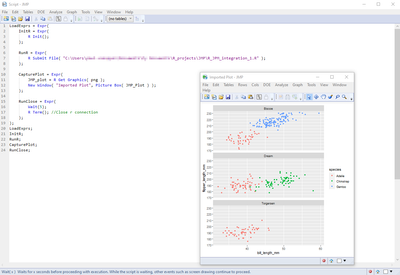

I found a workaround by forcing R to open a graphics window and explicitly plot the graph to that window:
library(dplyr)
library(ggplot2)
library(palmerpenguins)
windows(800,600)
p <- ggplot(data = penguins, aes(x = bill_length_mm, y = flipper_length_mm, colour = species)) +
  geom_point() +
  facet_wrap(. ~ island, nrow = 3)
plot(p)
I now need to worry about plot size but that's acceptable. Here's a screenshot of the script with the JMP graphics window:
