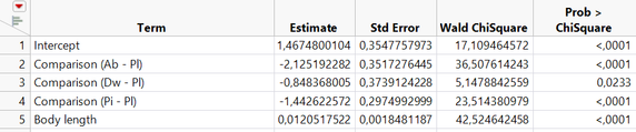

I have a dataset on one endoparasite in fish stomachs in a lake with four different fish phenotypes (Ab, Dw, Pi, Pl). The data fits well to a negative binomial distribution (see graph).
I use a generalized regression with negative binomial distribution to analyse (Y) number of parasites in the four fish phenotypes (x1) with body length (x2) as a covariate.
In the results (se output below) both x1 and x2 are significant and I want to extract "least squares means" in the four fish phenotypes after doing a multiple Tukey comparison (that contrast x1 and corrects for x2). What I get is the incidence rate estimates (with st.err). How can I "back calculate" to get real numbers (i.e. means) of parasites in the four fish phenotypes?
Number (Y) of endoparasites (X) in fish stomachs.
Output from analysis
Parameter estimates:
Tukey multiple test:

I utested which distribution that would be the best fit for y using AIC for different models where the negative binomial was etter than the poisson distribution. So yes it makes sense to use that distribution on counts of parasites. However, i still do not understand how to back transform the incidence rates to ordinary values eg after obtaining keast square mens from post hoc tukey testes.
