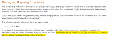

@Craige_Hales is certainly right -- unpacking is not a good term, sorry for any confusion!  The behavior I was trying to describe is documented though -- check this link: https://www.jmp.com/support/help/en/15.2/index.shtml#page/jmp/expressions.shtml
Here is the relevant bit:
Jordan
