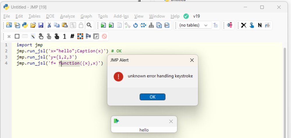

Maybe a related issue? :
The attempt to create a function via run_jsl with this JSL code:
import jmp
jmp.run_jsl('x="hello";Caption(x)') # OK
jmp.run_jsl('f= function({x},x)')   # crash
...  leads to a crash!?!

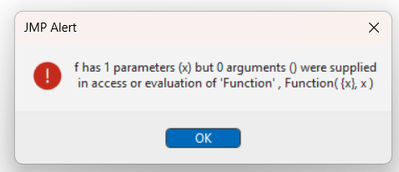

when you run the code line by line, you will get this error message:
3 REPLIES 3

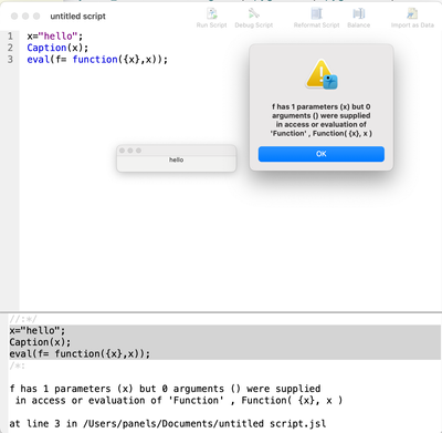

Re: Python & JSL function
A bug.  JMP 19?
I get a different error message on my machine but it appears that the run_jsl() is acting as if an eval(f = function({x},x)) is occurring rather just the assignment.
I was able to recreate what I was seeing from Python, with just running from JSL.

Interesting that
is different from
f = function({x},x).
So, it evaluates the argument before evaluating the return value of the argument?
Eval(print(1);Parse("print(2)"));
Significantly different:
  • with the Python code, JMP crashes on my system (maybe there is a difference between Win and Mac?)
  • with eval(f = function({x},x)) JMP shows a JMP alert and continues alive:
