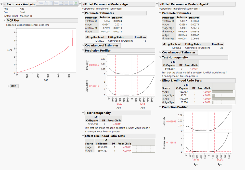

Depending on the shape of your actual data and on the model parameters you select, you can get very different models. Your simulated data has an anomaly at the end that can also alter predictions. From the data provided, I get very different models depending on if I include Age^2 or not. How well is your model fitting your data?

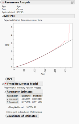

I just use the proportional PP model without scale or shape effect and the figure looks like following
There are two things that I don't understand:
why do you pick age as Scale Effect and Shape Effects? It does not generate a curve when you do so. Why is it like that? Where is the fit curve?
Why do you try age^2?
Thanks.

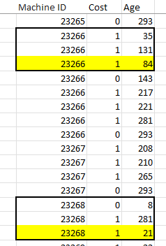

I'm not sure how much of an issue this is, but for Recurrence models, you're system data should be in chronological order, as I don't think JMP will automatically reorder them, but this will make a difference in your model. Here are two machine ID's in your sample data that were not in order. If this isn't something you see in your data, then you can ignore this.
