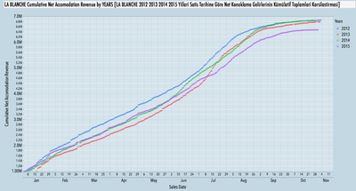

Actually I feel I am very lucky with this prediction, last 4 years data is moving within a 85% confidence interval  (Please see inserted pic).

But your graph of the 2014 data shows a monotonic increase that doesn't jive with the large numbers of zeroes (used to be missing) in the Revenue data.  So I guess I am even more confused with this new information.
The functional shapes on the graph all look similar year-over-year, and you may do better by just using the average of the functions at each day.  That would certainly be more parsimonious than my approach, and it may even be more accurate.  Remember, all you gave us was two partial years...
