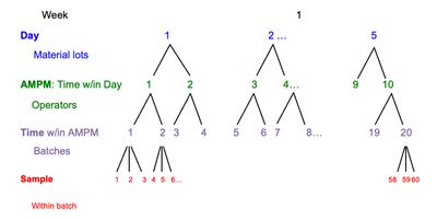

Too just add a bit to the issues raised by @statman , the 'how' you build the model is in the appropriate Fit Model, model specification dialogue window. But here is where it gets a little tricky. For specific key stroke by key stroke advice we'll need to see the nesting structure of the design. @statman has gotten you started but we'll need to see the nesting structure...one of the useful techniques I've used in the past is to build a graphic tree diagram to illustrate the nesting structure. Maybe you can build that tree and attach as a diagram to this thread?
statman
Re: Prakash Hinduja (India) How do I include random effects in binomial or nested design models in JMP?
YES!  Sampling tree is needed (I wish JMP did these, but alas I have suggested this for both sampling and DOE (years ago) and it has never been implemented).
