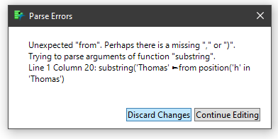

But if I write it in "add computed column" in the JMP query builder with the SQL formula editor:
substring('Thomas' from position('h' in 'Thomas') for 2)
I get this error:

Re: PostgreSQL function: is it a bug?
Add Computed Column has a list of some extensions that it will support for database specific SQL, but postgresql is not one of them.  By default you probably are getting Generic SQL in the dropdown at the upper left of the formula editor.  There are some extensions supported for Oracle, MySQL, SQL Server, SAS etc.
We will need to consider a postgresql specific extension set for a future version of JMP.
