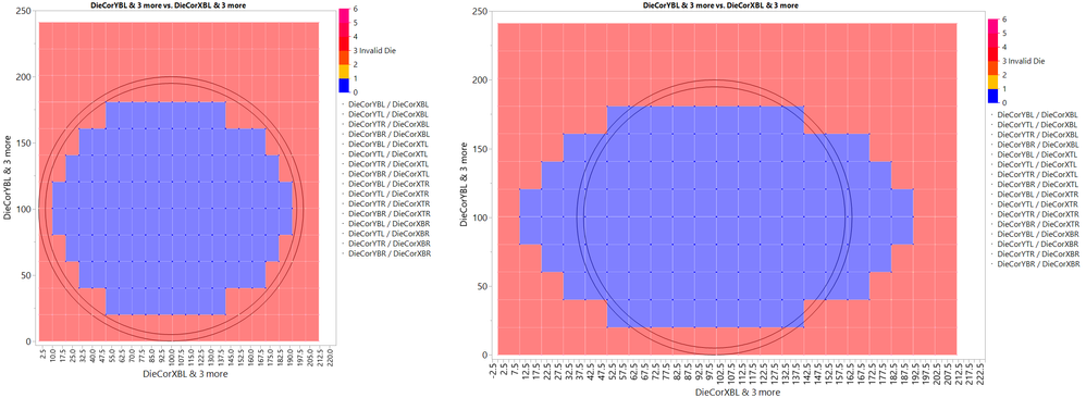

Plotting circles in graph builder that is locked to the coordinate system
Hi,
I am drawing too circles onto a graph builder wafer map using
Circle( {100, 100}, 100 );
Circle( {100, 100}, 95 );
in the right click in GB > customize-submenu.
But the circle is always round with reference to the pixels in the monitor. It is not really a circle with reference to the underlying coordinate system on the X/Y axis. For example I can drag the window wider and the circle will stay a circle, whereas it should become an oval as shown below.
Do you have any idea how to solve my problem?
Thanks
Re: Plotting circles in graph builder that is locked to the coordinate system
Try using the Oval function, which takes all parameters in data space.
1 REPLY 1
