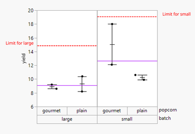

Re: Plot range for each group in variability chart
Thanks Jim,
This is what I want. How could I approach this using Add Graphics?

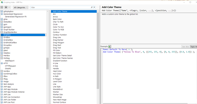

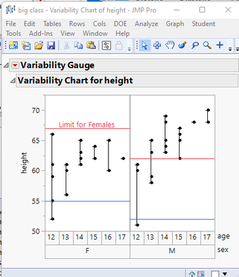

Here is a very simple example.  All of the Graphics functions are documented in the Scripting Index, under "Graphics
Names Default To Here( 1 );
dt =
// Open Data Table: big class.jmp
// → Data Table( "big class" )
Open( "$SAMPLE_DATA/big class.jmp" );
vc = Variability Chart(
	Y( :height ),
	X( :sex, :age ),
	Show Cell Means( 0 ),
	Std Dev Chart( 0 )
rvcf = Report( vc )[framebox( 1 )];
rvcf << add graphics script(
	Pen Color( red );
	Line( {0, 67}, {6, 67} );
	Line( {6, 62}, {12, 62} );
	Pen Color( blue );
	Line( {0, 55}, {6, 55} );
	Line( {6, 52}, {12, 52} );
	Text Color( red );
	Text( {1, 67}, "Limit for Females" );
Jim
