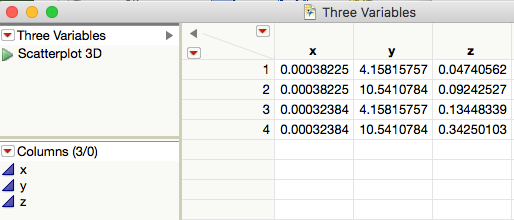

Generally, JMP Platforms expect the values for each variable (in this case 'x', 'y' and 'z') to be in their own column. So for your data I think this would be:
You could then try, for instance 'Graphs > Scatterplot 3D'.
You can also use JMP to rearrange the data into this shape, either by hand or using a script. But the details will depend on exactly how you read it in from Excel.
