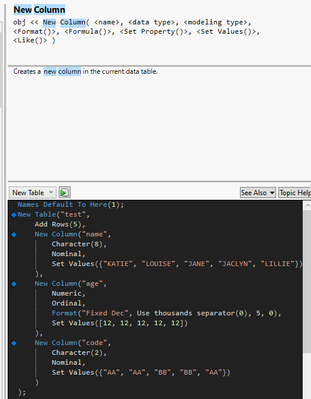

jthi
Re: Phase shifting to normalise sine wave data
Syntax after creating the new table seems to be wrong when you are trying to create a column? I would suggest checking out JMP Scripting Index (found from JMP help menu) and Scripting Guide (jmp.com). Both have good examples (sometimes) on the .jsl syntax
Scripting index:
Data Tables (jmp.com)
-Jarmo
