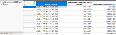

I am new to JMP and I am trying to batch process many .csv files. My first hiccup is happening when I try to pull datetime information from the first column.My data table looks like
 As you can see from the picture, each row of timestamps has an unwanted "-0800" tacked on the end How would I get rid of this for each entry? The jsl syntax I used looks something like
:loggingTime = Substr( :loggingTime , 1 ,  23)
However when I run this, I just end up with an empty column. Lastly, I know to ultimately format the string into a datetime object I will need the "informat" command  but my question there is can I select a format that records milliseconds and that doesnt just stop at seconds? I know this is simple stuff but as I said I am new to JSL and any help would be greatly appreciated.

if you run this script, it should fix your LogingTime data
Names default to here(1);
For Each Row(
     :loggingTime = Substr( :loggingTime, 1, 23 );
Formats will automatically loop through each row, but scripts require one to do the looping within the script.
Concerning your informat issue....Here is a format that if you create a new column, and specify the below as the format, it will convert your LoggingTime to a JMP date time value.  All you need to do then, is to specify the DateTime format you want to use for the displaying of the value
num(format(informat(date,"yyyy-mm-dd h:m:s"),"fixed dec",23,3))
