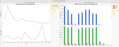

Hi everyone,
I have a question about saving a dashboard as a PNG in JMP 16. I found an example in an old question, but it doesn't work for me.
I received this response:
Unresolved name: dash at line 13 while accessing or evaluating "dash", dash/*###*/
at line 440 in D:\Project JMP\Scripts\PourcentageDeNokParJour.jsl.

NokBoard = dash << Get Windows;
NokBoard << Save Picture ("D:\Project JMP\DashBoards\ProductionPercent-NokPercent_DashBoard_of_"||current_month||".png", "png");

Re: PNG Export Issues for Dashboard in JMP 16
my bad, I forgot the ";" after Run.
) << Run ;
6 REPLIES 6
jthi
Are you getting the dashboard when you run the script?

Hi @jthi,
I have a question: I tried to change the line and bar colors in Graph Builder but I'm not sure how to do it. I created a dashboard you find the code in my last message where i have ask for help in the export Issues of the dashboard and attempted to modify it with code, but I haven't had any success.
Fill Color( "" ),
Line Color( "" ),
jthi
Do it interactively in JMP: right click on the legend and you should be able to change the colors and get the script from red triangle menu
-Jarmo
Yass
Level IV
Thank you.It works !!
