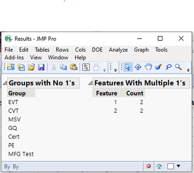

I am not exactly sure what you are looking for, but here is a little script I wrote that produces the results I think you want
Names Default To Here( 1 );
dt = Data Table( "MuMover Example" );
colNames = dt << get column names( continuous, string );
Remove From( colNames, 1, 1 );
Remove From( colNames, -2, 2 );
columnsWithNoOnes = {};
For( i = 1, i <= N Items( colNames ), i++,
	Summarize( dt, byGroup = By( colNames[i] ) );
	If( Contains( byGroup, "1" ) == 0,
		Insert Into( columnsWithNoOnes, colNames[i] )
featureWithMultipleOnes = {};
countOfMutipleOnes = {};
For( i = 1, i <= N Rows( dt ), i++,
	temp = Loc( dt[i, Index( 2, 10 )], 1 );
	If( N Rows( temp ) > 1,
		Insert Into( featureWithMultipleOnes, i );
		Insert Into( countOfMutipleOnes, N Rows( temp ) );
New Window( "Results",
	H List Box(
		Outline Box( "Groups with No 1's",
			Table Box( String Col Box( "Group", colNamesWithNoOnes ) )
		Spacer Box( size( 15, 0 ) ),
		Outline Box( "Features With Multiple 1's",
			Table Box(
				Number Col Box( "Feature", featureWithMultipleOnes ),
				Number Col Box( "Count", countOfMutipleOnes )
Jim

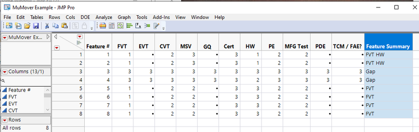

Thanks for getting back to me Jim. I should have been more clear on desired outcome.  My goal is to have a Feature table showing what group has entered an 1 in their cell and if no groups have entered a 1.  For example: in the table above the first feature has two groups showing a 1, FVT and HW, so  for that feature the outcome would be FVT HW.  For feature 3, no group claims a 1, so outcome for feature 3 would be "Gap".  Hope that makes sense.

Thanks Jim!
